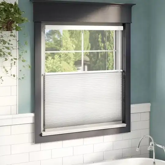

Opening the top sash allows for ventilation while maintaining privacy via top-down-bottom-up blinds, obscuring textured glass, or a similar solution for the still-closed bottom sash.
top down bottom up blind
