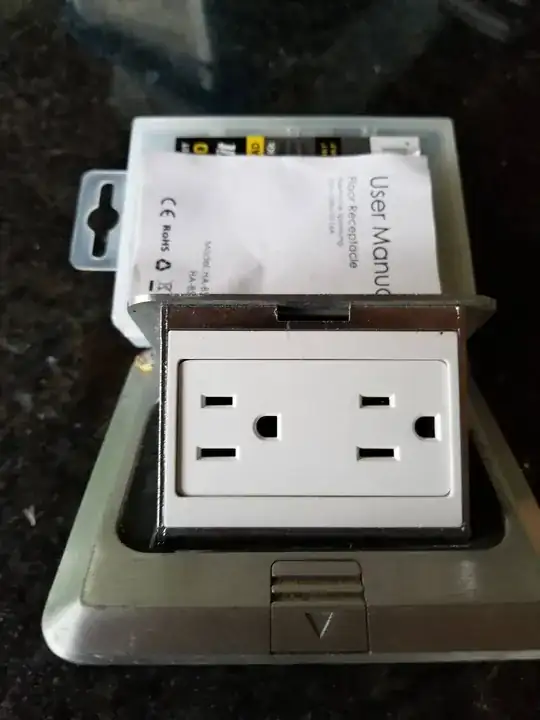

I purchased a 220 V outlet and didn't realize it. My circuit is 15 amperes. I wanted to hook up a series of normal 15 ampere 110 V outlets. When I look at the outlet it looks exactly like a regular 15 ampere 110 V one?...but it has a red, blue, and yellow wire instead of black, white and green wires.
The red wire connects to the brass screw (where black normally goes), the blue wire to the silver screw (where white normally goes), and the yellow to ground (where green or brass wire normally goes). The instructions are in German and/or English.
It looks like the outlet is just a metal backing and a plastic face. It should be ok to hook up these outlets and use them as 110 V ones, correct???
Is there anything special about the way a 220 V or 110 V are made?

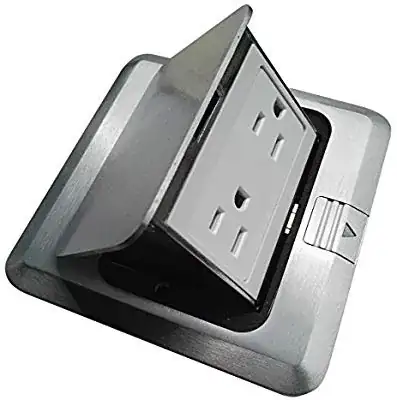

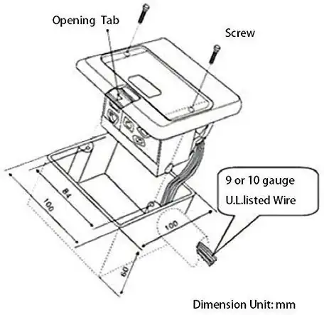

Pop-up floor receptacle diagram of receptacle with installation measurements
frontview of pop-up receptacle underside of pop-up receptacle with incorrectly labelled instructions

While what you have is indeed a 120V outlet (the outlet configuration governs, not some text in a manual somewhere), this outlet is not usable in a countertop or work surface in the USA, as it is not listed or labeled for use in a countertop or work surface, as requred by NEC 406.5(E) through (G):
(E) Receptacles in Countertops. Receptacle assemblies for installation in countertop surfaces shall be listed for countertop applications. Where receptacle assemblies for countertop applications are required to provide ground-fault circuit-interrupter protection for personnel in accordance with 210.8, such assemblies shall be permitted to be listed as GFCI receptacle assemblies for countertop applications.
(F) Receptacles in Work Surfaces. Receptacle assemblies and GFCI receptacle assemblies listed for work surface or countertop applications shall be permitted to be installed in work surfaces.
(G) Receptacle Orientation. Receptacles shall not be installed in a face-up position in or on countertop surfaces or work surfaces unless listed for countertop or work surface applications.
So, you'll need to return it and get something else that has an actual UL/ETL/... listing for this application.

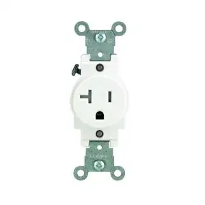

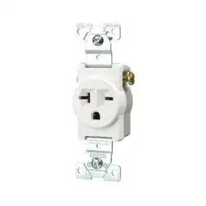

This is a 220V outlet (note horizontal "live" slot on the right):
(Photo of a NEMA 6-20 outlet)
And this is a 110V outlet (vertical "live" slot):
(Photo of a NEMA 5-20 outlet)
Pictures valid in USA.
