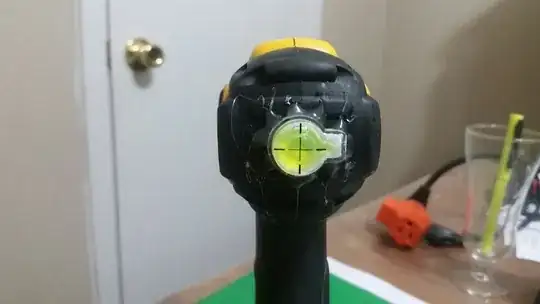

I would like to add a level to my cordless drill.

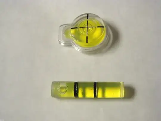

I saw this and thought it would work if I added it to the back of my drill.
I thought I would position the drill in the right position and then glue the level to the back of the drill to where the bubble is centered.
Do you think it would work?
Level
fixit7
  • 1,329
As Jsotola alluded to,
You would have to use a Long drillbit and Clamp it in a vice so that the drill bit is plum and true on all sides.
Then chuck the drill on to the drill bit.
Then you could glue your bubble on so that it is indicating level.
Good luck to you.
Alaska Man
  • 13,792
I used a hot glue gun using the milky colored glue sticks.
