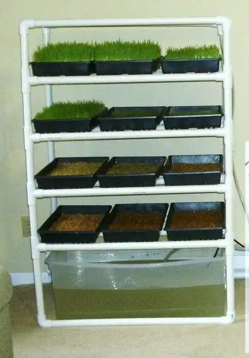

Edit: The title has aquarium to create right imagination for water pumps but I'll do fodder system like this: enter image description here
I need to raise water from the reservoir to the top of the shelves. I know aquarium motors will be usefull and cheap but I found washing machine motor 3 times cheaper.
