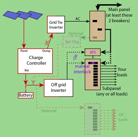

This is an XY problem at the industry level. Imagine some guy says "Design me a dimmer" and you design him an excellent triac dimmer, no big. And then he goes "Cool, can you just tack on a VFD onto this thing?" Facepalm, not in any elegant or cost efficient way.
So it is with solar panels. Everybody and their dog is selling 2007 tech, a solely grid-tied system because it's established, built at scale, and financial models are well established for sharing profits with the finance company, etc. etc. They can build, sell and finance that all day all night. It's the cheapest way to get you in the door and talking about solar. But they are selling system X.
Now, post-Sandy, there's the hue and cry to "bolt on" off-grid capability, in a manner compatible with dumb consumers. They did it, but it's inelegant and pricey, like bolting a VFD on a triac. The interlocking-for-linemen takes extra resources. I'd call it System XX.
For what you want, you want system Y.
And since you presumably don’t want to design every inch of it from scratch, we should grab out of the traditional "off-grid solar" parts bin. That means a few minor concessions.
The inverters are simply too different
A grid-tie inverter needs to follow grid frequencies, take all its input power, and force it all onto the grid by pushing voltage as hard as necessary.
An off-grid inverter needs to generate its own AC frequency, take only enough input power to do the job, and provide only as much power as the loads are drawing.
These are dramatically different roles and one inverter doing both will be a costly engineering challenge. They do exist; there are "hybrid inverters" on the market capable of both. Of course they are pricey and have their own system design requirements, not least batteries. You are probably better off getting cheap commodity COTS inverters for each application.
That said, your "No batteries whatsoever" plan is flawed. There will be cases where you have loads simply too big for the panels themselves to carry, e.g. motors starting up.
An off-grid system, "plus"
This is where I want to raid the parts bins of the off-grid solar people. The only thing that isn't out of their wheelhouse is the grid-tie inverter, but that's no big.
Their systems are violently battery-centric, for obvious reasons. Because of this, there is no viable way to avoid it, but nobody says your battery can't be tiny. Last I checked, they sell used car batteries for $20, there ya go.
Now in the house, we have a main panel with the main breaker. It has 2 breakers in it: The breaker to the grid-tie inverter, and the breaker to the subpanel.
The subpanel is where the magic happens. It has a $23 Siemens or Square D style "generator interlock" which backfeeds two breakers (one at a time). One side it's on utility, the other it's on "generator" (read: off-grid inverter). Every load you ever foresee running off solar goes in this panel. If you put every single load in your house in this subpanel, I won't tell :)
"Normal" operation involves the subpanel interlock in "Utility" mode, the off-grid inverter driving into nothing (shut it off), the charge controller instantly topping up the tiny battery, and diverting all solar power to "dump". Dump then goes into the grid-tie inverter and is sold back to the power company.
"Power out" operation, you throw the interlock to "Gen", power up the off-grid inverter. As the off-grid inverter draws to supply household loads, the charge controller diverts power to it as needed, blocking the rest of available current from the panels (since "dump" is a dead-end). If a motor starts and pulls more than panels can deliver, then we see how good or big your battery is.
And, if experience shows you it's advantageous to have a real battery, you can get one.
Note that in all cases, power flow is one direction only, and nothing ever reverses flow. That is a huge advantage over the "System XX" type setups, which flow power every which way, and need to "bolt on" elaborate, expensive interlocking systems to avoid backfeeding. Here, backfeed protection is a plain interlock, except for the grid-tie inverter which is UL 1741 compliant; you can't find a grid-tie inverter that isn't.
The whole system is cheap, scungy, simple, bottom-tier tech. That's not to say "don't use good stuff" - yes, of course use Morningstar or Midnight Solar charge controllers. But we're using their standard boilerplate gear, not special-purpose exotica.

What I'd go with if I was being cheap is the automatic version of Harper's approach
If I was trying to do a multimode solar system inexpensively, what would come out would be similar to Harper's diagram, save for two things:
  1. I would not put the whole house on the standby inverter system. This keeps most of the truly colossal loads off the standby system, and allows it to be kept reasonable-sized, especially if you can manage heating your house without having to throw a bunch of electricity at the job. In fact, I would restrict the standby inverter to (perhaps a subset of) dedicated lighting circuits, as well as a few key fixed loads such as the well pump, refrigerator, and (standby/emergency) heating system. Hot water is perhaps an option as well, but you will want to maximize your efficiency here if you do this, which means that a cheapo electric tank heater is not an option, and tankless is out as well.
  2. Instead of using the manual transfer interlock Harper describes, I would use a combination ATS/subpanel to feed the AC standby loads, with the standby inverter taking the place of the "generator" input on the transfer switch. (A Cummins RA112L1 is suitable for this provided you feed it with 12VDC from a DC-DC box off the battery bank so that the transfer controls can be rigged to work right; Kohler makes such a thing as well, but in a NEMA 3R box, which works outdoors, but is hard to use indoors.) Like Harper's approach, this allows the use of any old sine-wave inverter for the standby inverter at the cost of perhaps limiting what you can use for a grid-tie inverter based on your charge controller selection, but it provides automatic changeover functionality as well, for less cost than a hybrid inverter runs for.
Of course, if you aren't crunched for budget, I would look instead at a system based on a hybrid/multimode inverter, as that combines all the inversion and transfer duty into one box, giving you the net effect of Harper's System XX without the inelegant, "bolt on" design. Either way, this allows you to use less-expensive battery technology (such as marine deep cycle, golf cart, or AGM lead-acid batteries), which is another cost benefit over what you are being proposed with the Powerwalls, depending on how much battery cost factors into the equation of course.
