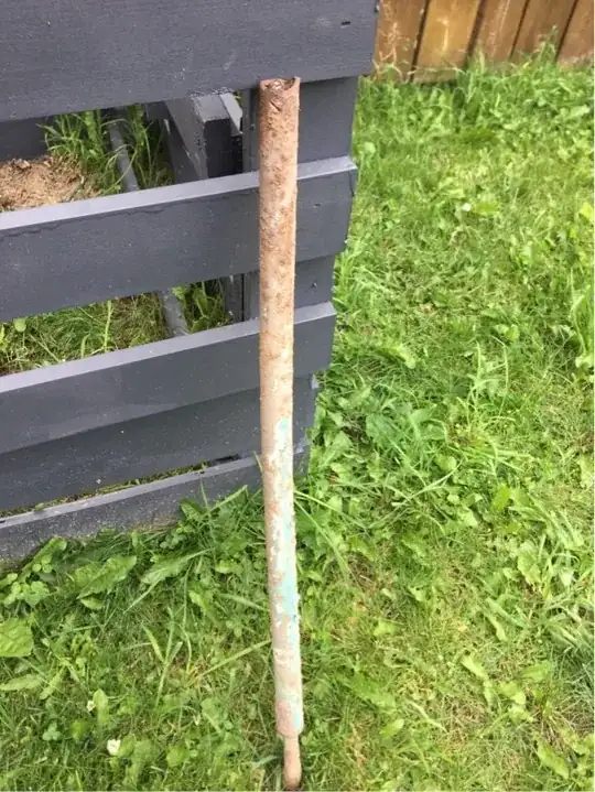

EDIT 3.5: Because if all the interest and concern over the pipe, see photo. It was well inside my property line and I assume it was once used to hold a flag or sign.
PIPE
