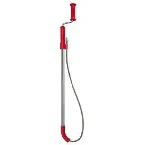

A little too eager I bought a drain auger in order to clear out a constantly / randomly backing up toilet. After I got it home I thought I should then do research and I realized there is a completely different auger just for toilets.
So, can I use a drain auger on a toilet clog?

The toilet auger is designed to protect the visible finish at the bottom of your toilet where a drain auger could leave scratch marks. It's also possible for a drain auger to get twisted inside of the large diameter of the toilet drain. Given the issues with the drain auger, I'd recommend going back and getting one designed for the toilet.

You should not - the geometry in a toilet trap is different and a regular drain auger isn't the proper tool. That being said, it most likely won't make it worse.
