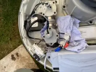

I got an electric shock whilst in a Lay-Z-Spa Vegas.
It was leaking from the thermostat housing, with water leaking and dripping on the heater causing a short to travel through the water pipe.
I took the top of the thermostat housing and found the square rubber seal split. I used silicone caulk to repair the seal and refitted it.
No more leaks, no more shocks. Happy spa days!
