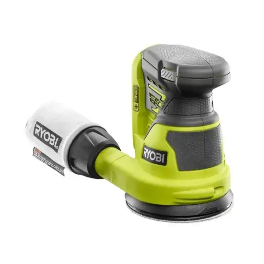

Assuming I already owned a 5" random orbital sander (similar to below example image), would it be realistic to use it with 220+ grit sandpaper rather than a "full-fledged" floor buffer, at least to the level where I can use it between a few coats of poly and still achieve a good finish on the final coat?

I did exactly what you're suggesting a couple years ago on ~500 sq ft of hardwood floor, with great results. As long as you have a semi-decent sander (connected to a vacuum) and decent sandpaper that doesn't clog all the time, you'll be done in no time. In fact, you need to be careful not to spend any time on a single spot or you'll sand right through the whole poly layer. Perhaps a second or two per square foot was about right in my case.

You could, but I wouldn't. It's just going to be a lot of tiring work (the sander is moderately heavy, at least for moving it around while sitting or kneeling on a floor you're working on) and possibly take off more material than you want if you're not careful. When I finished wood floors, I just used large-size sanding sponges (very light) and a few passes back and forth by hand. Other answers have remarked that you could do the same with sandpaper (or a sponge) on the end of a broom/pole of some sort, and that sounds even better still.
