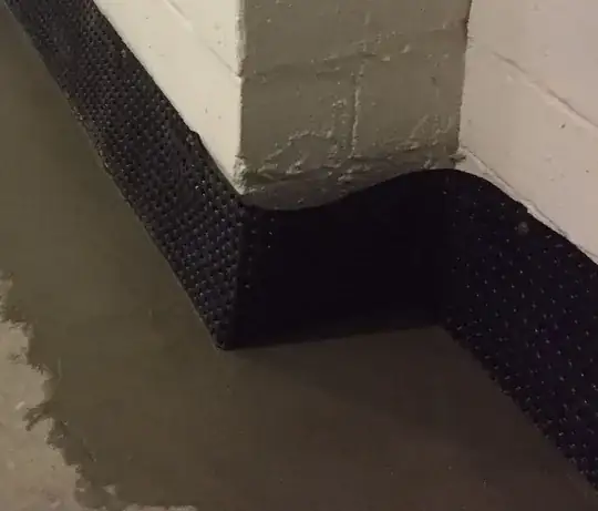

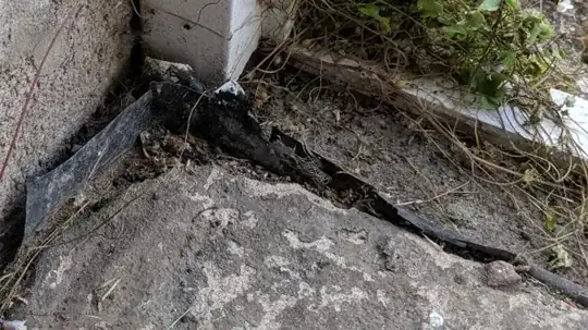

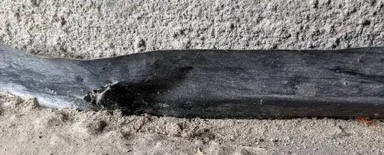

Photo of the DPM protruding from base of wall: photo of damp proof membrane DPM around door
Around the single door frame and garage roller door entrance the DPM is already trimmed down to be flush with the ground, so I believe I should be able to trim this off but this is my first time ever having to look into doing this so I want to be sure.
Link to the floor tiles: Rolson garage floor tiles
If the garage isn't below grade, doesn't have a sump pump on its level, there's no drain pipe open to daylight out in the yard and you don't have holes drilled at the base of the walls. Then yes, you can cut it down, as it's just newer concrete of this century that normally requires a water and vapor barrier...typically it's clear or black 6-mil polyvinyl sheeting required by code.
If yours were a very minor part of a proper drying or water handling system it would be hard and stiff plastic that's bubbled or ridged, like the picture below. Drain Tile Connector.jpg
