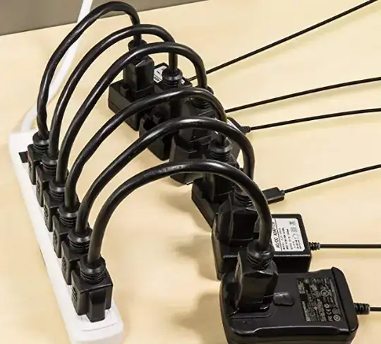

Power supply units are often large relative to the outlet and block access to adjacent outlets in a power bar.
A simple solution is to use 1/2 ft or 1 ft (15cm, 30cm) power extension cords to keep all outlets in a power bar available.
Yet my hunch tells me that doing so increases the fire risk.
Could someone with actual knowledge in the matter pitch in with an opinion?
Does unblocking power bar outlets through short extension cords increase fire risk?
I am not considering an exotic setup (daisy chaining, forking, etc..), nor will the wattage be high (laptop and paraphernalia, at most a stereo amplifier in one slot). The question is whether this increases the risk of fire. The idea is that there are now many more places where rust, or just a poor contact, will happen. And rust/poor contacts cause heat that can spiral to something sinister.
multiple short extension cords

Yes, but negligibly.
Any connection increases fire risk by increasing the chance of heat buildup due to resistance, sparks due to arcing, etc. The question is how much, and the answer is not much.
Since you already probably have dozens of such connections in your home (including such high-current things as a microwave and kitchen range), and since most of these are low-current devices, I see no reason to be concerned.
One caveat would be the potential for heat buildup around the transformers. They're normally held captive by wall outlets or power bars and not likely to end up in a heap on the carpet. In combination, many transformers without good cooling airflow could overheat. Don't let that situation arise.
Make sure all hardware is in good working order and be happy.

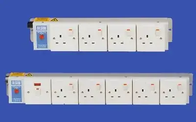

The problems of 'greedy' power supplies can be resolved by using power bars which have proper individual sockets for each position. They also tend to have better quality contacts than the cheap multi-way strips.
olson multiway socket strip
from
https://olsondirect.co.uk/oldsite/13a_standard_flat.htm
They also do USA standard ones, eg
https://olsondirect.co.uk/oldsite/usa_15amp.htm

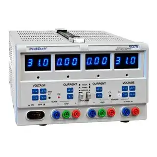

An alternative solution for your photograph is to use a single larger+higher capacity PSU and connect the low power devices directly. A lab power supply would be ideal and can be set to a variety of voltages, but generally only one, maybe two voltages, so don't connect 5V and 12V things to the same line. https://www.priggen.com/media/image/product/930/md/peaktech-6075-regulated-laboratory-power-supply-2-x-0-30v-dc-0-5a-5v-3a-fixed.jpg

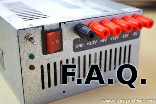

They're expensive, so a DIY solution is to convert an ATX PSU from a computer to a bench power supply. Example: From https://blog.adafruit.com/2012/12/04/converting-atx-power-supply-to-lab-bench-power-supply-f-a-q/ and an index of projects at https://www.instructables.com/id/Encyclopedia-of-ATX-to-Bench-Power-Supply-Conversi/

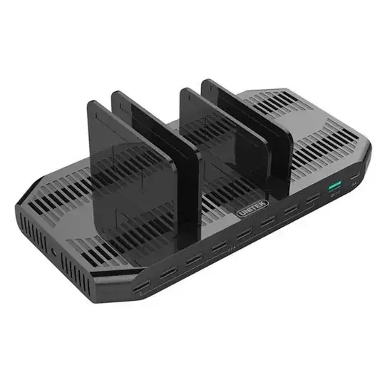

You could simply replace multiple USB chargers with a single USB power supply, like this 10 port charger:
https://cdlnz.com/content/images/thumbs/1262466_Y-2190__y2190_550.jpg
capable of 9 devices at a time plus a QC port to charge a laptop at 60W, or something smaller like :

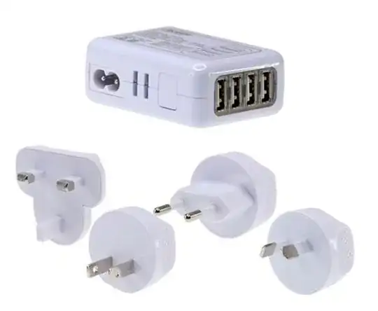

https://cdlnz.com/content/images/thumbs/1239623_PTA7724__pta7724_550.jpg
capable of 4 devices at a time.
