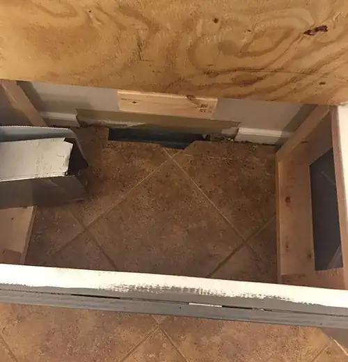

Got a window bench put in, but need a way to direct the air from the old baseboard vent register hole to out the front of the bench. NOt so sure a box store is going to have the proper vent duct parts I need in the correct shape. This guy online makes something exactly for it but it'll cost $72 shipped which is ridiculous: https://toekickductor.com/product/toe-ductor-baseboard-vent-kits/
Any help is appreciated. I'm not so sure I'll be able to cut a vent boot / trim, but maybe.
vent hole is about 14" x 2", register hole in front of bench is about 10" by 4"

Why do you need a duct? Most bathroom vanities, for example, are wide open from a slot in the floor to the louver on the kick panel. Just close off the compartment by any convenient means and call it a day. Staple some cardboard in if that works.
And parts from a big box store should work just fine. A common 2x10 or whatever size duct could be laid right in place with an opening cut in the bottom for the floor vent and the flaps flipped outward to close the rest of the opening. I think you're thinking too hard. It's just air. :)
