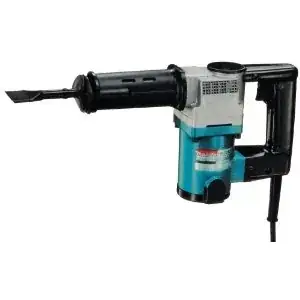

Like Greebo says, you want to get back down to the concrete, but I'd suggest that more to have a flat surface to build on top of. To make the job go faster, you can use a power tool. Several would get the job done:
Power Chisel (best fit for the job):
power chisel

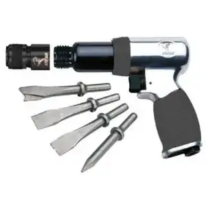

Air Hammer (you'd need a high capacity air compressor):
air hammer

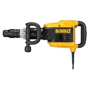

Demo Hammer (more power than you need, but it could be useful for other jobs in the future):
demo hammer
