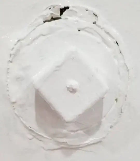

thickly painted square protrusion on round surface with cracked paint around perimeter
I noticed there is a square knob sticking out of my basement wall. Does anyone know what this is?

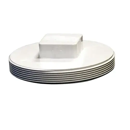

It looks like a sewer cleanout plug:
sewer cleanout plug
Scrape off the paint around the circle and you should be able to turn it with a wrench. Though sometimes it can be a bit hard to turn, particularly if it has been painted over and untouched for many years...
However, you might never need to remove it. You only need it if it provides a good location for cleaning a blockage in the pipes. But you definitely want to know where it is for when you really need it.

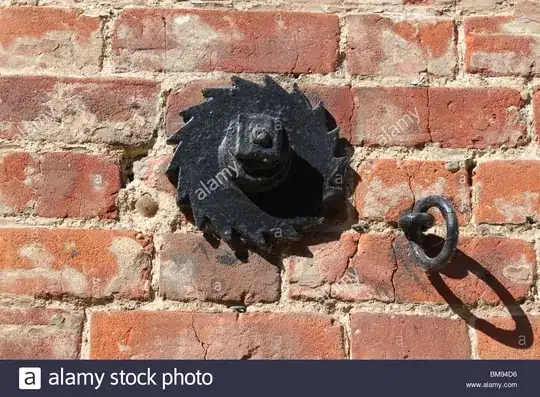

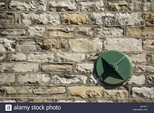

A less likely possibility is that you're looking at the internal head of some foundation repairs, given this is inside a basement and therefore underground.
An older building may have had extra work done to install reinforcing against quake damage or subsidence. The round part would be a load spreader (big washer).
This is more likely if there are multiple fixtures spaced evenly both horizontally and vertically over the wall. One single installation by itself is unlikely to be a tie end.
Examples - two photos of old brick walls, with retaining plates visible on the outside. These will be secured through the brick to vertical rods which have been drilled down through the entire wall.
https://c8.alamy.com/comp/B47R17/anchor-plate-or-wall-washer-in-the-old-gooderham-and-worts-distillery-B47R17.jpg via google images
This photo shows cracking in the brick around the load spreader. In a decent earthquake, this would likely fail completely.
https://c8.alamy.com/compit/bm94d6/il-vecchio-muro-di-ferro-tirante-utilizzato-per-rafforzare-vecchi-edifici-costruiti-con-soft-di-mattoni-e-malta-di-calce-bm94d6.jpg from google images
These are also installed on the other side of the wall, and can be highly decorative as well as functional. "Pattress Plate" is another name for them.
