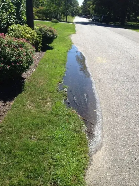

I have a problem with water pooling in front of my house. Between my Sprinklers and the rain there is always a puddle where my lawn meets the street.
The puddle
What do you think is the best way to stop this puddle? I can't reslope the street or regrade my grass. Nor do I want to pay the money to have a professional put a drain in.
I was thinking of drilling some 1" holes and filling them with loose stone or sand. I have never drilled holes in asphalt and I am not sure if this is something I can do with my regular drill.

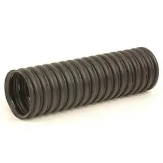

Start by digging a trench right next to the road about 12" wide, and 12" deep (don't forget to call before you dig, so you don't damage any underground utilities). You want the water to drain away, so you'll want a drop of at least 1/8" for every 1' in length. For example. If the drain will be 20' long, the end of the drain will be 2 1/2" lower than the beginning. Next fill the trench with about 4" of crushed stone, and lay your drain pipe in the middle of the trench. You can use either rigid, or flexible pipe.
Fill the trench to about 2" from the top with more crushed stone, then finish filling the trench with topsoil. plant grass, and enjoy.

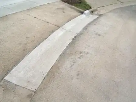

Concrete gutter
If you're familiar with working with concrete, and you like a more finished look. You could install a gutter, along the side of the road.
Just remember, you'll need the gutter to slope so water will run away. It's probably a good idea to install a dry well or other drainage method at the end of the gutter, so the water has a place to go (unless you don't care if you simply move the puddle to your neighbors yard).

Is it a public road? If so, then the road, the puddle, and some right away from the edge of the road belongs to your village, city, town, county or state. That puddle is bad for the edge of the road (look at those cracks heading toward it), ask them to fix it. Write a nice letter, or attend a local government meeting.

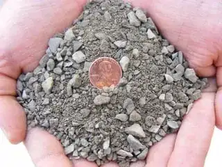

This Is Not Pea Gravel, which will never settle, it's called fines or fine gravel, 2 to 4 mm. You can build up the lawn with dirt and fight cars to get grass to grow or acknowledge that the roadway is incomplete and treat it as such: shore it up with a few yards of fine gravel. In a rural area, you might be able to sweat talk the municipal material yard officer into helping you out, with that picture.
