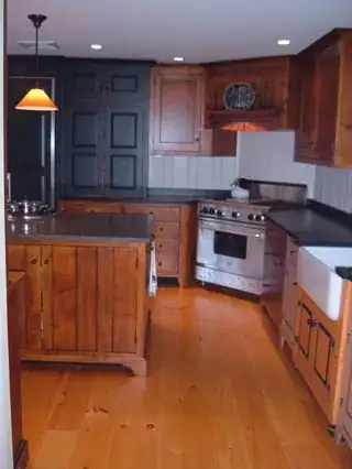

I want to redesign my kitchen with new cabinets so the stove becomes corner mounted (45 angle) which means moving the stove about 9 feet along the wall (towards the center of the house) into the corner so it would look like this.

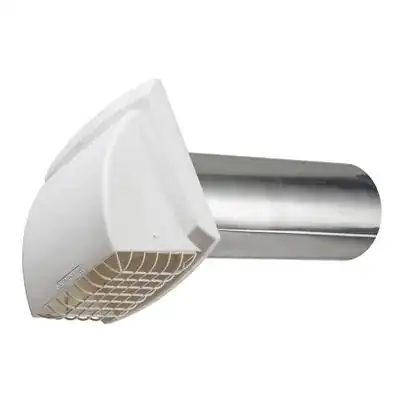

If your range is against an exterior wall, you might consider a unit that will direct-vent behind it to outside. Cutting a single hole to vent it might be easier than trying to re-route the entire vent. One the outside you install a wall vent like this:
Vent Hood
(source: homedepot.ca)
