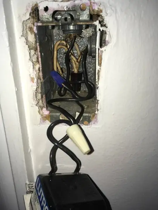

I think the black wires with the white and blue caps are the hot ones, and maybe the brown wire is ground or neutral?
I'm trying to replace it with whats in the second image but not sure what the SW1 wire is (pass through maybe)?

Someone else will probably post a more complete answer soon, but you need to figure out which of the black wires on your old switch is always-hot, and which is hot only with the switch on. Always-hot connects to live on your new switch, and switched-hot connects to SW1. Neutral gets added to the white wire bundle in the back of the box, and ground connects to a screw into the metal chassis (because the conduit is your ground here).

The light colored insulated wires are the neutral. They connect to the white on your switch. I might see two bare wires tucked behind the others. If they are there, those are the ground. They connect to the green on your switch.
Turn off the breaker to that switch and disconnect both black wires. Turn the power back on and use a multimeter to determine which is hot and which is the switch leg. The hot black wire will go to "live" on your switch. The other black wire goes to your light fixture and connects to SW1.
