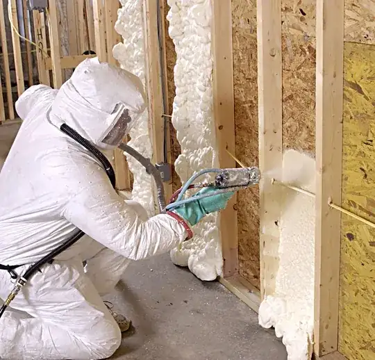

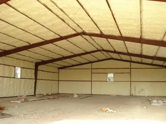

The fastest but definitely not cheapest way to handle your problem is spray foam. With spray foam (closed cell foam being preferred over open cell foam) you spray (or have someone spray) a liquid compound into the wall cavities and the liquid foams up and then solidifies. What you get is a dense, seamless, tightly packed rigid material that has excellent insulation qualities and acts as a vapor barrier all on its own. In your case you could spray the walls and roof in one day and almost instantly have a workable warm space.

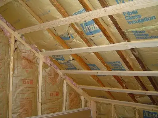

IMO THIS is how you install paper backed fiberglass:
Flaps folded over the studs, and stapled down. (Then tape the seams for extra measure as well as taping any tears). I still also don't trust paper as a vapor barrier, though often times its paper/plastic laminate in which case it'll probably be fine.
Alternatively you can install an unbacked style (no paper, just insulation) - and then you add the vapor barrier by adding a layer of plastic, like so:
Here the plastic is hung up over top of the insulation, taped at its seams and so forth.

If you spray foam, however, since its rigid and 4" thick, you can leave it exposed.
