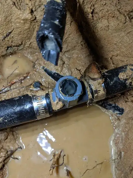

This reducer tee had a right-angle piece break off inside of it for a feeder line.
Broken Pipe
I tried cutting the black broken piece inside of the reducer section without success. I'm used to schedule-40 PVC, not the black line shown in the picture. Is it possible to replace only the right angle piece? These black lines are very stiff and I'd rather not have to dig further back along them to gain the flexibility to replace the reducer tee, not to mention I haven't seen a piece like this at the big-box store from which I've sourced all the parts for this project so far.
If I can't salvage the tee, what's the best way to get it out? I've already cut off the hose clamps, but haven't gone so far as to destructively remove anything from the hose or the tee itself. I can easily replace the clamps - I'm just not sure if I can replace the tee via standard retail channels, and if that replacement would be such a pain that it's worth it to try replacing just the elbow.

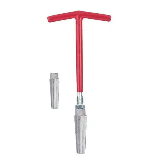

User Matthew is correct that a nipple extractor may help you salvage the tee.
You need to check the threads in the Tee for any damage, since if the threads are scratched you may get a leak.
If the tee is badly damaged
If the tee can’t be reused, you will need to replace it. This part is readily available at any home-improvement store (but see below).
It’s good that you can remove the pipe clamps if needed, but the Tee fits into the end of the hose with a very tight pressed fit. You may need a “vise-grip” style clamping wrench to get a good enough grip on the fitting.
You may have to cut the black polyethylene hose to get the tee out. In this case you may even need a straight coupler to repair the black hose.

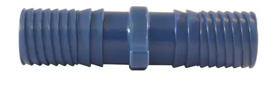

Here is a cheap one for less than a dollar:
coupler This is a relatively fancy one, but even this only costs $1.28:
coupler

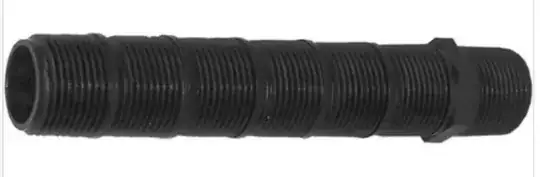

cutoff nipple- avoid
The correct replacement is to use a flexible riser pipe, or “swing joint”, known in the trade as a “funny pipe.”. Funny pipe is flexible and will protect the fitting from future damage so you don’t have to replace it again.

There is a tool called a nipple extractor. It can be used to remove broken threaded parts just like this.
You can find one online or from any irrigation supply or DIY retailer likely for under $15.
You firmly press it into the broken part and turn to remove it.
