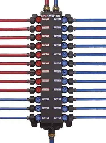

The Viega Manabloc is an example of a system in which a central valve manifold uses a dedicated tube for every fixture in the house, as alluded in the comment from BillDOe. image of Viega Manabloc manifold
