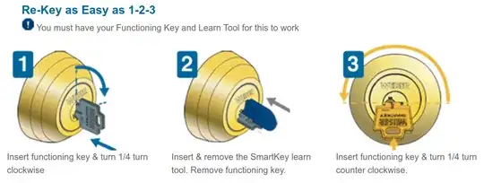

You say "they don't need to be high security our anything", so perhaps you could consider SmartKey - Re-Key Technology & Key Control - Weiser.
You can rekey them yourself in literally 10 seconds each. The first time you do it, it will take you longer, simply because you've never done it before, but it really is trivially simple to do.
Any time you want, you can rekey them again, with no expense other than the cost of cutting new keys.
It's also handy if you need to temporarily give a key to a handyman. Rekey it for that purpose and then change it back afterwards.
(I know this sounds like an ad, but it isn't. I've personally found this to be a handy and useful system. But it's definitely not as secure or well made as some other products.)
