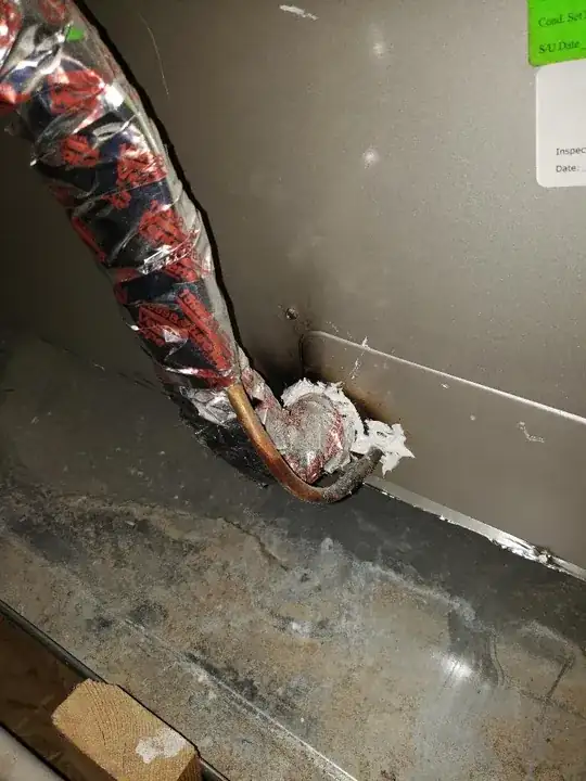

What caused these burn marks?
Burn Marks on Air Handler
Phoenix Arizona suburb. House was construction complete about 6 months ago.
The tape and insulating foam around the bigger tube was cut. I assume the AC tech that came out to investigate the bad fish smell (see below) did the cutting, but I don't know for certain.

The burn marks on the air conditioner air handler are from the torch the installer used to solder the copper pipes to the unit. The pipes then go the compressor located outside the unit.
Most installers can do this job without scorching the unit.
