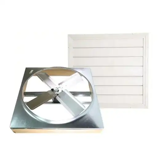

Last year I installed a whole house fan similar to the one below. It vents into the attic so when it does get cool out, I open windows and turn on the fan. It sucks air into the house and cools off the attic. I had to install 13 additional soffits in the eves but it was well worth it.
