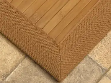

Would a bamboo rug work?
alt text
It'd be easy to roll up when not in use. I don't know if it's a great dancing surface, though.
