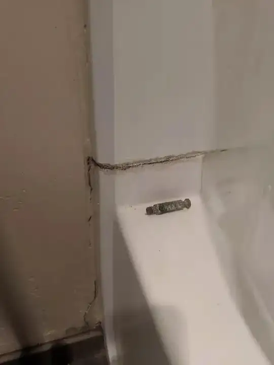

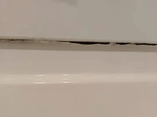

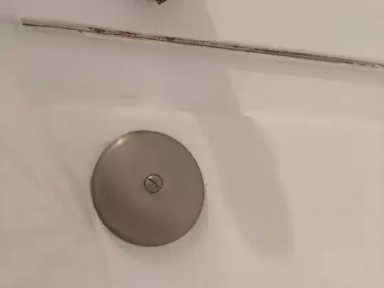

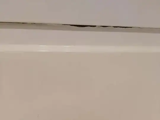

I noticed after years of usage, there are some cracks in my bathtub (pictures attached). I am not sure how bad they look and whether or not if I need to fix those cracks? and if I do, how can I fix them by myself if it is easy?

I'm not sure where some of those cracks came from, but it doesn't look like anything a good quality bathroom caulk won't fix. Here is the big secret to caulking anything in the bathroom:
Clean those surfaces as good as you possibly can. Like cleaner than you've ever cleaned anything in a bathroom. After its super clean, clean it again with alcohol to make sure there is no residue at all.
Once it's clean, use a high quality silicone bathroom caulk (don't try to save a few bucks - you're buying one tube). Let it dry properly before use and enjoy a leak free tub.

You can fix this, potentially fairly, easily. Get some Silicone caulk from your choice of hardware store. Then read the directions which will probably say something like clean the area to be applied and apply a bead of caulk.
Here is the potentially part: depending on how long the crack has been there and what material was used there could be water damage/mold behind the shower/tub. Fixing this can be time consuming and expensive. From the pictures this doesn't look like it should be an issue but depending on how long they've been there it is a possibility.

Honestly, this is something you'll deal with periodically anywhere you have a caulked joint. I caulked my son's bathroom about 18 months ago and some of the caulk is starting to break down from regular use. You can use a basic latex caulk, but they just don't last as long. A couple of things to consider
  1. Pure silicone. It's a MAJOR pain to remove, smells terrible, and is mineral spirit cleanup only, but lasts a long time. The same can be said of an outdoor grade caulk.
  2. A siliconized latex caulk (like this). Don't buy the cheap stuff

Is it a crack or a seam where the tub base joined to the side-walls? If it's the latter, most likely there is a 'lip' attached to the tub wall, extending up about a 1/2' from tub acting as a 'dam', designed to keep water, running down the shower walls, from seeping behind it. You might be in better shape than you think
