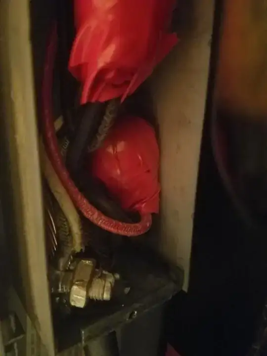

enter image description hereWe are pulling an old Jenn-Air range and replacing with a separate Jenn-Air stovetop and oven. Due to the downdraft they cannot be placed on top of one and other but will be in adjacent cabinets. The current electrical setup for the range is a double 50 Amp breaker with an 8 gauge wire that supplies the unit. Since this is in an island set into a concrete slab there is no way to run new electrical lines. The new oven is 3.6KW and the stove is 7.0KW. The minimum circuit and wire sizes are 20 Amp/12 AWG and 40 Amp/8 AWG according to the installation manuals. Can we run a 12 gauge wire off the existing 8 gauge wire to serve the oven and keep them on the same circuit? I will have an electrician make the connections, but for planning purposes I need to know whether this electrical setup will be OK.

Since some nitwit thought burying a /2 SE cable in a slab was the best thing since sliced bread, your project is now in a predicament due to the lack of separate neutral and ground wires in the cable. This missing wire problem forbids you from fitting a subpanel here (as you'd need a separate ground for that), and it also forbids you from running further cables from here due to issues with the NEC 250.148 requirements for terminating EGCs conflicting with the Exception to NEC 250.140 that permits continued use of existing 3-wire range circuits.

The way this works out is that you'll have to build a sturdy structure inside the cabinet bay where the old range outlet was to mount the transformer on as it has to be mounted upright in order for the cooling to work out correctly; this structure will need to be anchor-bolted directly to the slab instead of being attached to cabinet components, as well, due to the aforementioned weight issue. From that existing box location, the installer can run a 3/4" LFMC whip with 2 6AWG stranded THHN hots and an 8AWG stranded bare copper ground in it to the transformer; this connects to the primary side of the transformer, which is strapped for 240VAC use with the hots connected to H1/H3 and H2/H4 at the the transformer and ground connected to the transformer's grounding lug. Note that this may require replacing the existing junction box with a larger box: a 4-11/16" square box provides enough room here to connect to the existing cable. Also, the split bolt that was used for the original neutral/ground connection needs to be removed and replaced with a compression connection as this equipment grounding conductor is doing double duty as a grounding electrode conductor as per the Exception to 250.121.
