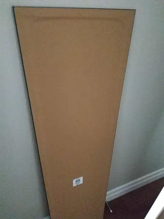

I would like to safely secure a mirror to the drywall. The mirror itself is pretty light (probably under 5kg), the weight is not an issue. However, its back surface does not have any hooks or anything that can be used to secure it. I was going to use a string and some nails, but I am not sure it will work, the wooden part is really thin. Any ideas? Perhaps, some adhesive tape?
UPDATE
Thanks everyone for your answers. All of them are great, it's hard (perhaps, impossible) to pick the best one. Because the mirror is light, I decided to use a wire and small eye bolts attached to the sides of my mirror.

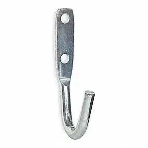

Hooks
You can also try hooks like these, but they might also allow the mirror to walk off the end and would damage the paper backing. These can also be used with D-rings and wires, but generally not with sawtooth hangers.
Wall hook
Gorilla hooks

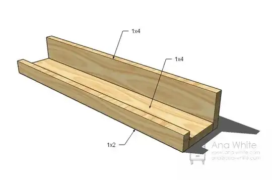

You could use a shelf with a ledge on the end like this:
moulding
or possibly amazon moulding
amazon link
to secure the mirror.

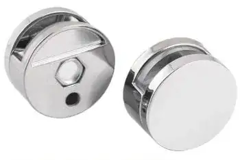

You can get mirror brackets/clips intended specifically for this use. Here are two examples:
(of course, you need to get ones in a matching color and texture or color them yourself etc.)
