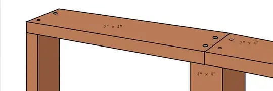

What screws can I use to securely attach a 2"x4" to a 4"x4" treated lumber? The solution would need to be rust-proof.
I recently used a structure similar to the image below for a small fence, but some of the screws are completely full of rust, due to treated wood humidity and the environment. I have to change that.
I was thinking of screws but any other solution is appreciated.

People use the wrong screws outside quite a lot, but thankfully there are good alternatives. Outdoor decking and fencing are commonly assembled with coated screws advertised for such. They typically come in tan or green depending on the application and can hold up for a long time without rust or staining the wood.
Stainless steel screws are another option for even more rust prevention, but they will be quite a bit more expensive. This is pretty over the top unless you're building a boat dock or similar.
For larger fasteners, hot-dipped galvanized lag bolts are good. Galvanized screws might exist, but I'm not familiar with them. Certainly you can get galvanized nails, but I think that the coated deck screws must have filled the need that galvanized screws would have because I never see them.

Stainless steel deck screws will not rust. I've used them many times on all types of lumber with great results.
But screwing into end grain never works well, put a piece of 2x4 into each corner and screw into the sides of it. The joint will be much stronger.

In addition to the previous two answers, I recommend against galvanized hardware in pressure treated wood unless the packaging specifically indicates that they are suitable for that use. Afaik only hot dipped galvanized is suitable for use with PT, nails are often electrogalvanized.
