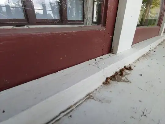

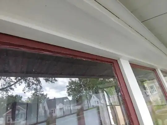

I recently bought an older home (1920's) with a glass-windowed porch. These windows are not affixed with any sort of track; They are simply on hinges and swing inward.
window top window bottom
They aren't great windows, but whatever, I don't intend to replace them anytime soon. Many bigger fish to fry and whatnot.
However, I do want to get some airflow through the porch, without pets escaping (or letting bugs in).

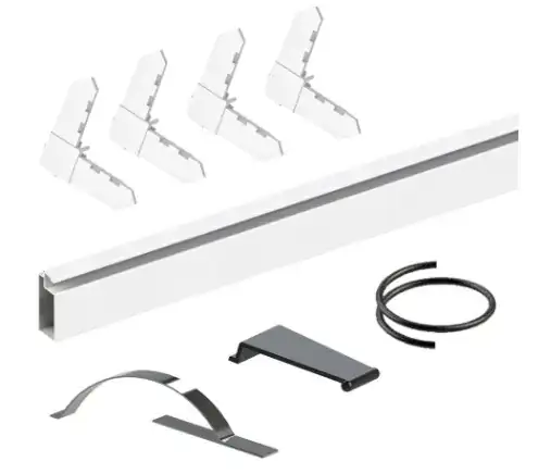

So far, I was planning to assemble and install a screen frame kit to each window like this one:screen frame kit
The big question here is, how can I mount this thing to my weird, simplistic, trackless porch frame? I don't care if the screen isn't generally able to be opened (apart from repair/cleaning of course). If I mount it into that inner area just outside of the red window (which seems best? It's a tad over 3/4" deep), I don't have any room for a bottom loop latch. Kinda seems like I need a "hacky" solution, which is probably fine, as long as it doesn't look terrible.

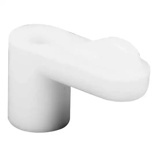

I'd say mount it on the outer part, like @JACK suggested. Otherwise you'll probably end up with some odd-looking custom bracket/track setup to accomplish what you're after.
Instead of the stud screw + wingnut combo though, they make screen clips that match the color and width of that screen kit you linked, which might look a little cleaner. Below is a plastic one (I only searched Home Depot though, so you may find metal ones elsewhere, if that's what you're looking for).
Screen Clip
screen clip
It might be worth investing in stainless steel screws (I didn't see what material the included screws were, but I kinda doubt they're SS), but at $0.30 per clip it doesn't hurt to try.
