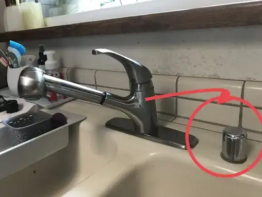

Possible easy solution: Look near your sink top near faucet for a 2 to 3” projection from counter or through a sink hole. Projection is usually silver but could be color matched to your sink or faucet. This is a dishwasher drain clean out. Lift off the metallic looking cover. Remove debris found there. Replace cover. Run dishwasher. Problem may be eliminated just that easy. I’m older than dirt, had many homes, this has happened to me maybe 4 times in nearly 60 years of so called adulting.
Dishwasher drain cleanout
