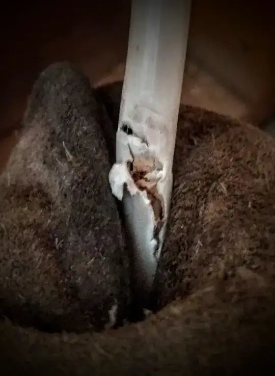

This electrical cable was tightly stapled to an inner stud. It passes through the wall to an outside light.
While prying the staple off, I tore the outer sheath. Wire doesn't appear damaged. Light still works.
So: Is it safe to electrical tape this and re-staple to stud?

You would have to inspect the individual wires inside that outer sheathing.
The black, red, and white insulations should be 100% intact and not nicked/torn in any way or else you run the risk of serious problems.
Whether or not this "fix" is acceptable per code in your area would be determined by the code in your area so when in doubt contact your county/city engineer and they will make sure you do it right.

I called an electrician.
They had to snake a wire all the way back to the adjacent room and put a box with a blank on it.
