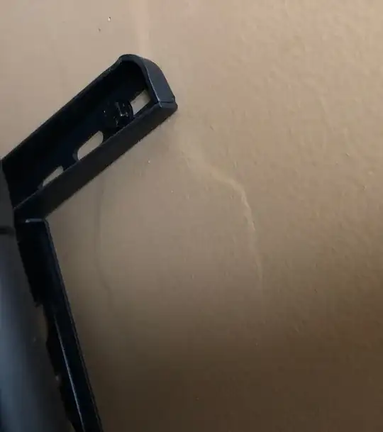

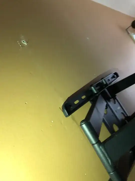

I mounted my 60” inch tv over my fireplace and a bulge has appeared on both sides in the last few days. I’ve done some searches and it sounds like this is a “nail or screw pop”. My question is this something I need to be concerned about? Can the tv come down because of this or rip the tv and mount off the wall? I used a stud finder and there’s 4 2 3/4 lag bolts into the studs but I just want to make sure the tv is safe. The tv covers the bulge/bubble so if the integrity of the mount is fine I don’t care. Any information or advice is greatly appreciated!! enter image description here
Ryan Mc
You do not need to be concerned, assuming that your lag screw is anchored into the framing.
That's a result of a pre-existing gap behind the drywall. Maybe some insulation or a wrinkle in the vapor barrier held it out during initial hanging, and your lag screw pulled it in tight. Because there was a drywall screw there holding it out the surface bulged as the rest pulled in. There are no apparent structural concerns.
If you ever remove the tv, you'll want to put a pair of drywall screws above and below the bulge before removing the lag screw. Then remove the tv mount, cut away the bulged drywall and repair.
