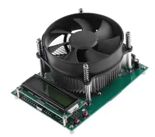

There are 'off the shelf' battery tester/electronic loads which handle up to 20 A/150 W at a fairly nominal price (considering that they have some degree of monitoring built in) - assuming that you are not really interested in designing your own here.
These use some sort of power FET coupled with a fan/heatsink and constant current control.
For clarity, this is exactly the sort of device where I would buy a low cost, bare PCB style product and import directly (for ~€20) rather than look for a traditional lab instrument.
Electronic Load
