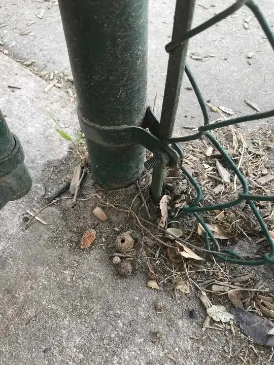

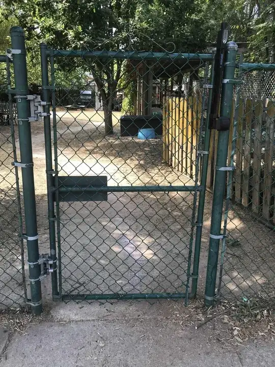

I need to correct a small problem with a metal gate post. When the gate is opened to its full opening, the leverage of the gate pulling against the gate post causes the post to spin inside the post hole and then the gate becomes misaligned with the attachment mechanism (on the right of the gate). Other than this, the post itself is very secure and stable. In the attached image, the post on the left of the gate spins inside of its post hole when the gate is opened fully. Additional image is provided to give you more detail on the post installation.
I'm trying to find a remedy to stop the post from spinning, but that does not require removing the fence post. Why? -- I don't believe there is adequate space around the post to dig it out and reseat it (due to the large amount of concrete surrounding the post).

It appears the post has a couple straps around it, one of which connects to the top bar of the fence. Try putting a bolt or self-tapping screw through this strap into the post. This way the post will be kept from spinning by being locked into the fence more securely.

Get a wider gate and fit the hinges behind the post so that the gate can swing flat against the fence without hitting the post.
The hinges are trying to go there already, they can't be stopped with that big lever available. If you try to stop them it's only a question of what will break.

If there is a place you can put it that won't be a trip hazard, a doorstop attached to the ground will prevent the gate from swinging too far.
The simplest (but not the nicest-looking) way to do it is just a piece of corner brace, like this one: Everbilt 4 in. Zinc-Plated Corner Brace (2-Pack)
There are lots of other options, including fancier metal pieces, wooden blocks, fake (or real) rocks screwed to the ground, etc.
