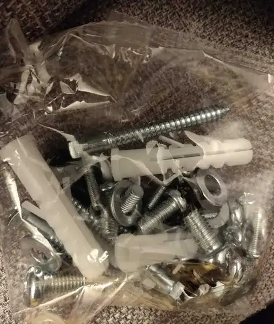

this is the hardware supplied with the holder:
the long screw on top is a wall-screw. the instructions are meant for wall bricks, so they say to put in the plugs first and then the screw - for stud-installation it says to do the exact same thing, just use a different drill-bit.
am i really supposed to put the plugs in the wooden stud? or can i just drive the screws directly in the stud without the plugs? the plug is 10mm wide, while the screw is probably like 8mm incl. threading or so.

I agree with unhandledexcepsean--I would use lag bolts for larger TVs. Some flat screens will be fine with the wood screws through the drywall into the stud not using the plastic expanding anchor. I have seen some smaller mounts where 4 of the plastic anchors into drywall are supposed to work but I do not like those at all.

Depends on the weight of the TV and the type of mount.
A lag bolt with similar inside diameter would have higher wood holding retention, but might not fit through the hardware on the TV, as the screw threads are typically much wider.
I would not drive these directly into a wooden stud. The screw thread is too fine, and the outer half inch would only be supported by sheetrock, potentially causing bending and pulling on the screw. It would also be hard to guess which size drill bit would maximize holding capacity.
The advantage of using the plastic mounts are that:
  1. Depth is set correctly, so the bolt will be flush with the sheetrock
  2. The entire bolt is supported at least partially by the the plastic collar
  3. The plastic collar will probably have less rotational friction than the wood (esp if you guess wrong on drill size), making it less likely to snap during installation.
Overall though, assuming you are mounting this straight to a wall, 4 bolts of that size seem like overkill for medium size TVs.
