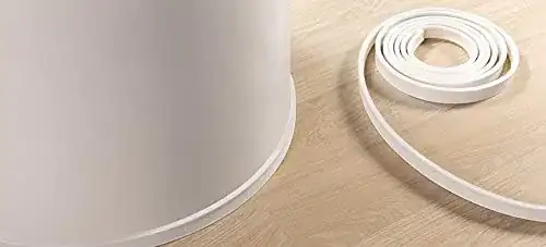

A quick Google search for "flexible trim" shows several items that should work. I don't know if they're any good but they're clearly designed to do what you want and there are several to choose from.
Here's one example called eXtreme® Quickstep Flexible Laminate Floor Beading & Skirting. The photo looks like it matches your description exactly.
And there's also something called Flexible PVC skirting which is taller but equally flexible since it also comes in a roll.
