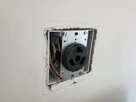

I am planning on putting beadboard wainscoting on a laundry room wall. I will need to add an extender to the dryer's 240v outlet to keep it to electrical code and have the outlet sit flush up against the extender. The beadboard will add 3/16" thickness to the wall.
I can't find a suitable product to use. I've used these in the past for 1-gang outlets, but there doesn't seem to be one for the bigger box. Which product should I use?
Here's a picture of the box, it is plastic and W: 3.75" H: 3.5":

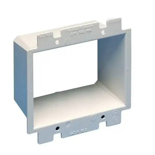

Use an Arlington BE2
What you have appears to be a two gang plastic box, so you'll need a two gang plastic box extender such as the Arlington BE2 or equivalent (picture below is of a BE2, but for illustration only. These should be available at any supply house worth its chops, and can even be ordered from the orange borg if you can't get it any other way.
Arlington BE2
