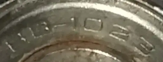

Upon inspection it is the rotating fan / motor assembly that is producing the noise, and that whole assembly can be removed for service / replacement. I've exposed the bearings which are noisy, but am having trouble identifying a replacement.
The bearing is stamped BB1023 but this doesn't seem like a standard bearing code. Does anyone know how to interpret this number and/or is there an equivalent standard code?

The way to find different bearings is by the size bb1023 crosses to a double sealed 6.35 x22 x7 mm bearing Mr627zz is the same id/od and 1/4” thick so it is slightly thicker and may work under 5 bucks. Looking at the bearing specs I would give it a try. I cross bearings for motors all the time, I can tell you a timkin or sky bearing in some cases is worth the extra but in a light duty motor like a fan I would save a few $ Mr627-2rs Mr627zz I thought I typed in the wrong size after double checking my answer but I just typed the size wrong in the answer corrected.
