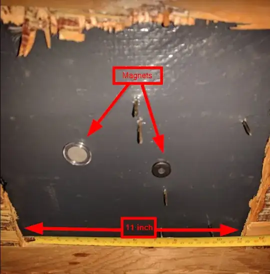

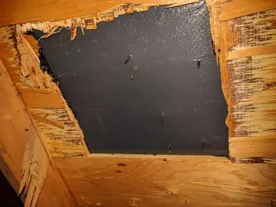

I recently went in my attic and found out that some part of the roof is missing plywood :( enter image description here enter image description here

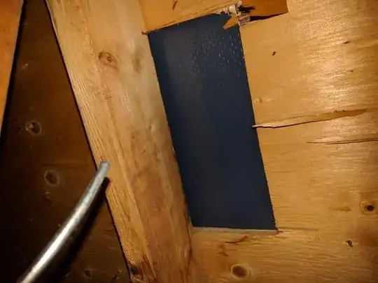

In the following picture, there is no nails visible. Which means the shingles behind are not nailed in??? enter image description here
When the contractor did the estimate, he did notice places where the plywood was rotten and told me he would need to replace them. Well clearly he didn't. He just cut away the rotten plywood :(
Is that normal practice. Should I be worried or is this ok?

So I did get in contact with the contractor. Apparently, this is where the old air vents were.
He tells me that there is a metal sheet between the shingles and the membrane. He told me that the membrane that we can see in the pictures is to protect against humidity.
Is that a good practice when removing old air vents?

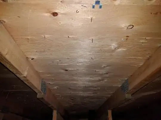

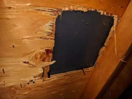

I went back in the attic and took more photos enter image description here
As for the proper amount of nailing, its really hard to tell. I'm no expert and I cant seem to see any kind of patterns with the nails. Here is a photo were I could sort of see a pattern. enter image description here

So first, I contacted the manufacturer of the shingles and explained the situation. They told me that the shingles installed over the metal sheet are NOT properly installed and that the shingles would NOT be covered under the High Wind Resistance Limited Warranty. They did suggest that I contact an inspector. The contractor that did the job was also certified with that manufacturer. So they will be looking into that.

As a R.R.C. and roofer for over 25 years, this doesn't surprise me. Anyone with a pickup truck and a ladder calls himself a roofer. This is wrong, if they eliminated vents they should have replaced the sheathing. An opening up to 4"x4" can be covered with metal, but anything bigger requires re-sheathing to eliminate a fall hazard. Also the nail pattern should be evident. Thinking you need to call an attorney. If he did this he isn't reputable so it stands to reason he won't back up his work. Always check references and reviews of your contractor. Check with the BBB to see if there are complaints. Look at their work!! Drive by a couple of their jobs, talk to homeowners if possible. Not only end result is important but being done without damaging your property and in a timely manner is just as important.
It is not acceptable that the roofing materials were replaced over the plywood cutouts (which actually look more like breakouts).
One can surmise that the stripping crew came one day and removed all the old roofing material and did the breakouts. Before calling it a day they rolled out the underlayment (a.k.a tar paper) and covered over the breakouts in the process.
The next day the shingle layers show up and start laying shingles not knowing about the breakouts. The wonder in this case is how they managed to avoid stepping through one of those holes!!
At this point there may be a fix by cutting a piece of like thickness plywood that can just fit into each hole. Then cut a larger piece that would span over the bottom of the hole. Use construction adhesive to glue the patch pieces in place. Short very carefully selected screws can hold the patches in place while the glue hardens (dries). In lieu of screws it may be possible to use strut pieces of wood between the patch and ceiling joists below to hold things in place till the glue sets.
This patch scheme will provide support to shingles above the hole locations. It may be difficult to resolve shingles that are not fully nailed over these holes but at least support can be restored.

WHAT, he eliminated your air vents? Wow, your update is so revealing: 1) sheetmetal is not an acceptable cover over large openings, 2) if sheetmetal was used, it was not nailed to the existing plywood, 3) he eliminated air vents,
  1. Sheetmetal is allowed to cover openings in plywood roof sheathing up to 4” x 4” only. Any opening larger needs solid sheathing. (Btw, openings need to be cut back to the next joist. It can’t just be nailed on one side to a joist.)
  2. Sheetmetal cannot be just laid on the roof or glued to the roof. It must be nailed to the roof. (I think most roofing manufacturers recommend nailing 4” on center.)
  3. The Code specifies how much venting is required. It’s not a random number. (The U.S. Code says 1 square foot for every 300 square feet of attic. I’m sure Canada is similar.) Do you have soffit vents or gable end vents? Regardless, the roofing manufacturer will void the warranty if you do not have the correct amount of venting.
I’d go to your local lumberyard and look at a wrapper on your type of shingle. (I’d photocopy it too.) You’ll see most of the requirements printed on each wrapper. Then I’d get on the internet and print out the installation instructions for your shingles. Then I’d call the Building Code office and see if a permit is required. If so, I’d show the building inspector the installation instructions and ask them to review your roofing project.

  1. Metal can be used if supported by wood blocking (pictured is CDX Plywood which is not a dimensional lumber that is also known as Wood Blacking). The width of the metal is not more than 400mm on center, it must be at least .33mm Galvanized metal or Aluminum at least .61mm in thickness.
    NOTES:
    1. Based the provided pictures Aluminum was not used as magnets do not attract to aluminum.
    2. Sheet metal does not have the static resistance that wood does and the design wind load when metal is used in lieu of wood decking is significantly lower and has a much higher probability of failure due to wind uplift. It is recommended that if metal is used for decking repairs that metal screws of a nominal Number 8 size be used in lieu of roofing nails.
  2. Nails shall have sufficient length to penetrate a nominal 12mm (a ½”) into the sheathing / decking. If the roof deck is 15/32 CDX Plywood then at least the tips of the nails should be visible from the underside of the roof deck.
