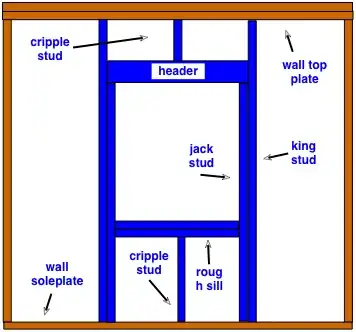

The opening you want to create has to be framed like a window as shown*.
window framing layout
Notice the addition of a header to carry the load of the cut stud (cripple stud) to the sides, and the added jack studs which support the header. Because you're only supporting a light weight cabinet rather than a window, you probably don't need the double sill (single will do).
As pointed out in the comments, you can't simply cut a load bearing stud without any issues. Some sort of temporary support must be put in place to carry the load before you cut into existing structure and not removed until the new structure is in place.

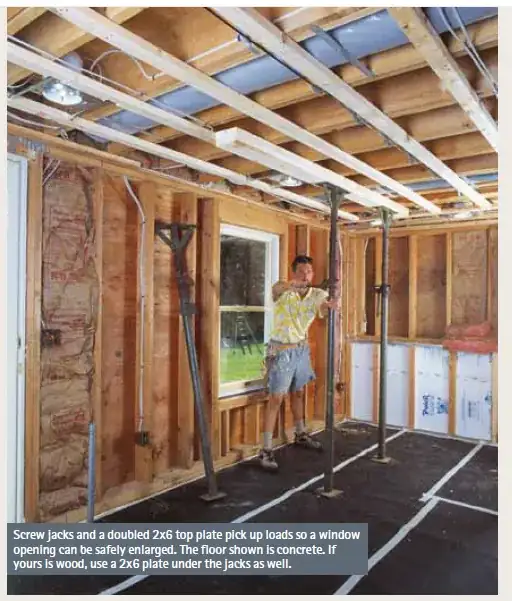

Just a note that shoring the ceiling while you make the wall/stud modifications is non-trivial business in itself. From Litchfield's Renovation, you have a couple of options, using screw jacks or even an entire temporary stud wall, parallel to the one you're hacking. The latter is probably overkill for what you're doing, so I'm only illustrating the screw jack method:
proper use of screw jack to support overhead joists
You may end up having to repaint the ceiling and/or even fix its drywall due to the potential damage to the ceiling finish from the jacks.
