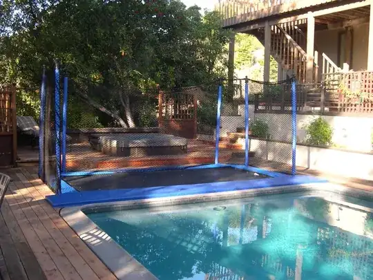

May not suit your needs, but if you could find a trampoline just smaller than the pool, it can be fitted and secured to the concrete.
That way bouncers (trampoliners?) could get on without having to go up a ladder.
Downside the pool below will still catch rainwater, so a sump pump could be required. Or a compromise with the other suggestions. Also depending on what's around the pool you may wish for extra crashpads or a style vertical-side walls.
This solution does serve the request for a "cover" and it could carry the weight of an average adult safely.
from http://www.confidencelandscaping.com/gallery/pools-water-features/in-ground-trampoline/ no connection - just a matching result from google images.
