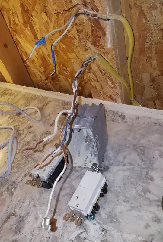

enter image description hereI have 2 outlets, I want to replace with switch outlet combo (outlet always hot).
But looking online, I keep seeing everything has only one white neutral, but in my case, both outlets have a black hot and white neutral wire along with the grounds twisted together. In other words, each outlet has its own romex cable with 3 wires.
Am I not able to replace this outlet with a switch combo because it has 2 neutrals?
This is confusing me. Thanks.
Let's take a look at what we have here
You have 2 cables, and each one has (presumably) hot, neutral and ground. It is normal for all grounds simply to be all tied to each other;
The old device is definitely a GFCI or AFCI, no doubt of it.
So what you're viewing as "each socket powered by a separate cable" is actually the GFCI device being what it is. It has one hot/neutral pair (called "LINE") that inputs power from the supply, and from there, power goes through the GFCI electronics. The output of the GFCI electronics provides a zone of protection, and that goes to the other hot-neutral pair (called "LOAD") to be carried onward to other outlets. It also protects the sockets on GFCI receptacles (not every GFCI device is a receptacle).
So each cable does not power each socket at all. The positions are sheer coincidence. Both sockets are connected together along with the LOAD wires, and all together are on the protected side of the GFCI.
Any socket-type outlet in the protected zone requires a "GFCI Protected" sticker.

Grandfathering: you can't downgrade
ALL kitchen receptacles are required to be GFCI. Even if this outlet was grandfathered, you can't downgrade: you can't remove protection you already do have. This means 2 things:
  • This receptacle must remain GFCI
  • The downline circuit must be protected by GFCI
Now as the other answer describes, the other receps could be protected merely by siting a GFCI at the next recep. However, this recep still needs protection.
Fortunately, a dual GFCI+receptacle+switch is indeed an item that is sold. It is exactly what you have there (the new one) but with GFCI protection on the receptacle. The wiring to the screws is the same as the old GFCI receptacle. The switch is not on any screws; it is handled as two pigtail wires which you can do with as you please. Noting that hardwired lighting does not need GFCI protection.
That 20A-keyed socket+switch is an expensive beast, having just bought one myself. Take it back. You may find the incremental cost to a GFCI version of that isn't much more than what you are returning.
