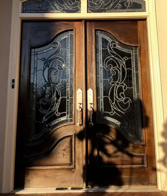

I have a Mahogany door that costs me about $700/year to keep it stained and covered in urethane. It is in direct sun and just takes a beating.
I don't want to put a storm door on it because the storm door will just raise the temperature even further.
I am tired of the time it takes; I am tired of the money it takes. I just going to have it painted.

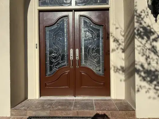

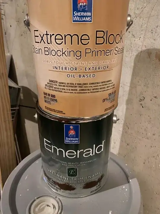

I had the door painted with this paint:
paint
The final door looked like this 2019-12-15:
door
I will add pictures over the years so we can see how it wears.
I'm in the same dilemma, $2.5k wood front door, natural finish. Stunning when its new. but its always the clear coat cracking after about two years in direct sun.
I have already sanded and re stained and covered twice in five years, ultimately yielding the same results, a cracked and ugly front door.
