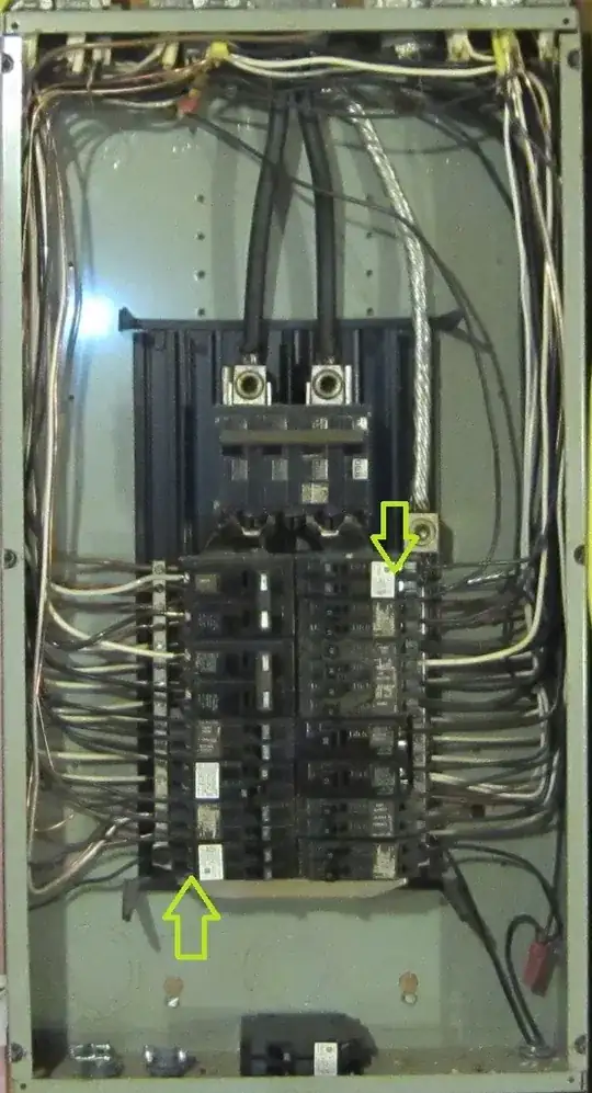

Please tell me how crazy I am. breaker panel

We could do some very difficult rearranging of panel space. However there's an easier way. There is a 20A 2-pole breaker in the left side center. We'll replace that with a 20/20 tied quadplex. Possibly a Siemens (ITE) Q22020CT2, which provides two tied 2-pole 20A breakers.
  • The inner breakers are tied and also are common-trip. I don't know what that existing 20A breaker serves, but it might need common trip. So we place that on the inner.
  • The outer breakers are tied, but do not guarantee common trip (they do promise common maintenance shutoff). They are suitable for this saw.
So for this saw circuit, remove the hot from the old saw breaker, and its partner former neutral (the one now marked with black tape). Both those go on the two (outer) hots on the new breaker.
