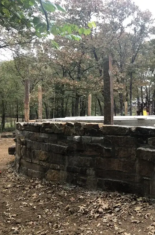

I have several solid stone pillars (approx 4' high) running along the edge of my patio. I would like to hang string lights along the stones using something like Q-Hanger hooks. But I do not know how to go about securing these hooks into the stone itself. I see online some plastic anchors that look like the kind that I would use in drywall but I'm not sure if that is the best option or if those anchors would work with the hooks I have planned.
Any advice would be appreciated.

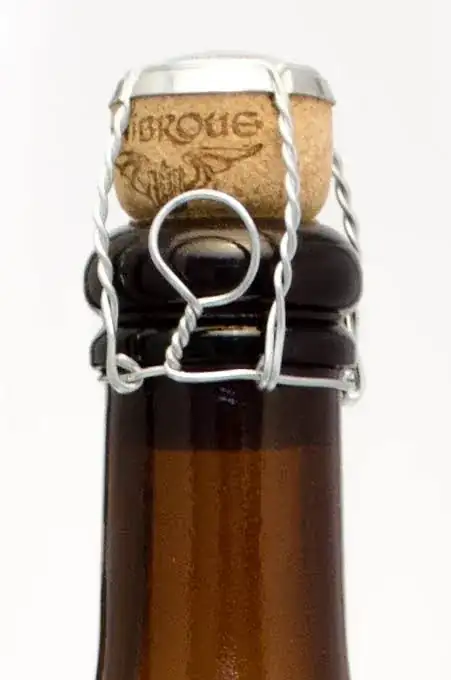

Get some aluminum wire for bonsai (example). It's anodized in a suitable color and very easy to work with. You could also use coated steel gardening wire (per Tonny's comment) or even coated copper electrical wire. Wrap it around the stone and twist it at the light location, then use the tails to attach the lighting. As Criggie suggests in a comment, you could use a wiring strategy similar to how sparkling wine bottle caps are done:

[Updated, since the target is the tall stone pillars, not the stone wall]
I would be reluctant to drill into the stone, not least because it may open the way to water penetration and frost-shattering. With pillars that tall it could be downright dangerous if they got frost-shattered and then broke. It may also be very hard work.
So look to methods that don't damage the stone and are reasonably inconspicuous. String or non-ferrous wire around the pillars (string can be dyed, unvarnished brass tarnishes to a brown that may be similar to the stone). Or, what I think I'd do, is to epoxy-glue some small cable tie bases to the stone.
