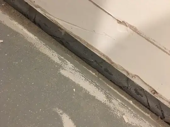

I have removed the skirting boards in my new build house, as I am going to fit engineered wood floor via the floating method.
The issue I have is that after removing the skirting, I was presented with these cavities at the base of the wall. They are around 2 inches wide, but vary in size around the room.
On the exterior walls there is also a gap in the flooring at the back of the cavity.
The interior walls have do not have this gap.
In addition to the below questions I was wondering the purpose of this gap?
I'm not sure how to proceed with the fitting of the floor though.
  • Should I just lay underlay and leave the cavities as they are?
    Would this not allow a draft under the skirting?
    Would it allow too much movement of the floor?
  • Fill the cavity completely?
    Would this affect any insulation/damp-proofing on exterior walls?
    What should the cavity be filled with?
  • Fill the cavity to within half inch of floor?
    This is how the walls were when I have previously laid flooring How would I go about filling to this level?
Appreciate any assistance with this and happy to provide any more information if required.

If you're putting back the skirting boards, you can get wooden beading/moulding to cover the expansion gap.
Alternatively you could use a thin bead of hidden flexible caulk underneath the skirting board if you don't mind having a gap, as this would stop drafts coming from underneath.
In my (limited) experience this 2 inch gap is normal on both plasterboarded and normal plastered walls. It seems like there's a few advantages - e.g., it avoids damp problems from the floor or spills, and also allows expansion movement.
