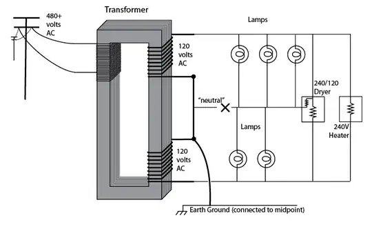

What's really happening
Look at my diagrams here that describe how split-phase works. What you have going on is this:
Notice how the 240V loads don't care, but the 120V loads are now out of balance. That's what is happening, and it's changing as loads are turned on and off. The two 120V legs will add up to 240V, but they won't be 120V.
