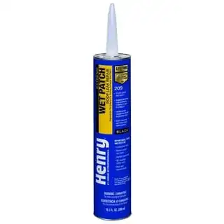

If you are looking to use a product under water then you can try a wet patch for roofs.
https://www.homedepot.com/p/Henry-10-1-oz-209XR-Elastomeric-Sealant-HE209004/100001308
