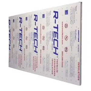

I have had great success using a 4x8 foot sheet of white foam board.

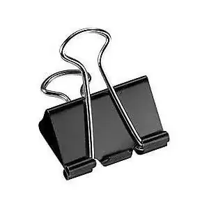

It is extremely light weight. I hung it from ceiling on strings attached to three binder clips or bull dog clips like show below.
When not in use find a place you can store it flat. If it gets broken it’s cheap to replace. If it falls on a child no one gets hurt. The white foam is a good surface for projecting onto. The one pictured below had foil on the other side but the plastic with lettering peels right off leaving a bright white surface .
White Foam Board Binder Clip

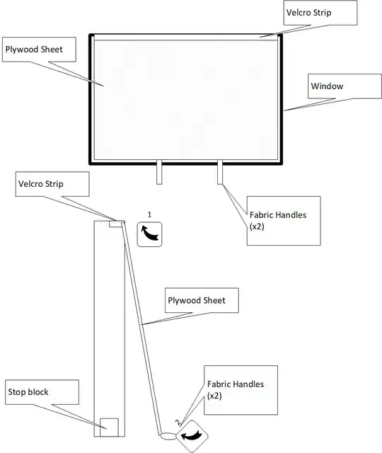

The wild and crazy, "probably-more-work-than-it's-worth" idea is to make solid shutters that fold to the sides of the windows when you want light+circulation. But, it appears that you already have the plywood. And, you want the projection area to exceed the dimensions of the plywood, so it really should be flush mounted with the wall and have as little gap between the plywood and wall as possible. You want to cut the plywood to fit closely in the window and then you need some mechanism to hold it in place. Hook & Loop (Velcro) fasteners along the top of the window/plywood to keep the top from sliding into or away from the window. Fabric loops attached to the bottom of the plywood to handle it when pulling out or pushing in.enter image description here The velcro "should" stop the top of the plywood from moving in or out, but it will not support the weight of the plywood. In this design we are relying on the window sill itself to support the weight of the plywood. I would strongly recommend installing "stop" blocks at the top and bottom to keep the plywood from indenting too deeply into the window (keep it flush with the wall) but also to allow you to put screws through the plywood into the stop blocks to prevent the plywood accidentally falling. The stop blocks can be simply 2x2x2 cubes cut from 2x2 stock and firmly attached to the window opening with 4" screws to engage the framing. Inserting the plywood into the window frame would follow the arrows, #1 lift the plywood into place engaging the velcro strip, #2 grasping the fabric handles slide the bottom of the plywood onto the sill. Gravity "should" hold it in place and the velcro "should" stop the top from sliding out. But for safety, screw it to the stop blocks. I only drew blocks at the bottom, but I would strongly recommend blocks at the top too.
