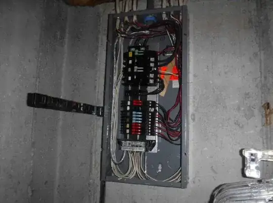

EDIT- breaker panel shown breaker box

Well Zinsco, you will find conflicting information online about them, but this is not debatable: The second law of thermal dynamics indicates things wear out. That panel is old, and design defect or not it is still time to replace it. Personally I've been opposed to Zinsco since the 80's, first house I rented had a Zinsco with a dryer, water heater, and well on the same 30A breaker. Lived there 3 months before a time delay fuse for the well blew and got me inspecting the wiring. I'm lucky that wire didn't melt in my sleep.
So back to your question, if you don't have room, ability, or desire to fit ALR approved connectors in the j-boxes with the GFCI receptacles then replacing your non-ALR GFCI's with ALR receptacles and installing GFCI protection at the panel might be an option. If you make the risky choice of sticking with your Zinsco panel GFCI breakers probably aren't an option, but you could consider "dead face" GFCI's at the panel between the breaker and the aluminum wiring. Dead faces are more expensive, but the code reads that GFCI protected circuits in the kitchen (or bathrooms) are only allowed to feed receptacles in the kitchen (or bathrooms).

Uh oh, you have a Zinsco...and that means that you'll have to replace the whole panel to have a hope of doing anything else to improve the situation
Atop the known woes with the use of "old technology" aluminum wire for general-purpose branch circuits, you have a bigger problem to fix: that Zinsco panel of yours. Given its penchant for starting fires due to breaker-to-busbar connection burnups, plain miscalibration of breakers (leading them to not do their job when called upon to stop an overload event), and even violent blowouts of the breaker casing during high-energy trips, the Zinsco breaker line is not worthy of the title "antique"; instead, that panel needs to be sent on a one-way trip to the smelter. Never mind the fact that Zinscos can sometimes not turn the power off when you move the breaker handle to OFF, rendering any attempt at servicing an electrical system "protected" by a Zinsco panel hazardous at best!
Fortunately, this looks to be a rather trivial job as far as service changeouts go, since your panel was surface-mounted into an unfinished space during the original install. I would get a 200A, 40-space or 42-space, main breaker, NEMA 1 (indoor) panel as a replacement for this, along with appropriately sized breakers for the various circuits in the panel. I would also point this out to the seller, though, as they sold you a house with what basically is a known defect in it, unless somehow everyone involved was not aware of the hazards Zinscos pose.
Note that when replacing the panel, pigtailing the aluminum wiring is not necessary to attach it to the breakers, as breaker lugs are made of plated aluminum to begin with, and have always been safe to attach to aluminum wire provided correct installation techniques are used; however, since you have aluminum wire, it is imperative that the lugs on your new panel and breakers get torqued to the correct specification values for that make and model of loadcenter using an inch-pound torque wrench and/or torque screwdriver. This is also a new Code requirement in the 2017 NEC (see 110.14(D) for details).
